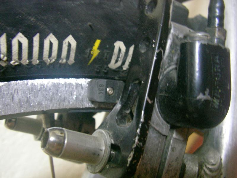

Note:
As what our PT gurus mentioned..Please wear necessary protective gear before using power tools such as angle grinder or jigsaw... better safe than sory Very Happy
share ko lang din how I grinded or should I say jigsawed my rim
the rim & the tire Very Happy
wala po akong angle grinder but I have this one
so I decided to give it a try if it will be able to do the same thing on the side wall of the rim
place th blade this way...and fire away
I gues it did work Very Happy
pasensya na kung wala sa focus mahirap mag record at mag grind ng rim at the same time. Embarassed
rim grind/jigsaw from reverse on Vimeo.
cheers! Very Happy

uh....
dapat kikil nalang ginamit mo. hehehe...
super mild yan. madaling maubos lalo na kung naka hs33 ka.
